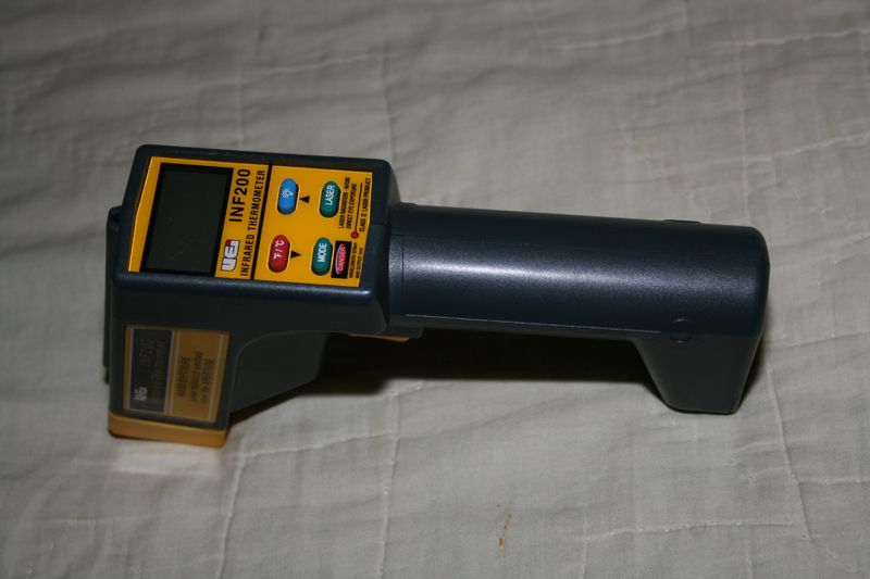

Temperature Readings
INF 200 Infrared Thmperature Gun
When this is being used, it is moved over the suspected hot spots. It records the max temperature, min temperature, avg temperature, and the change in temperature. It has a range of up to 1.5 meters before losing accuracy. and can accurately measure temperatures within -40°F to +788°F.

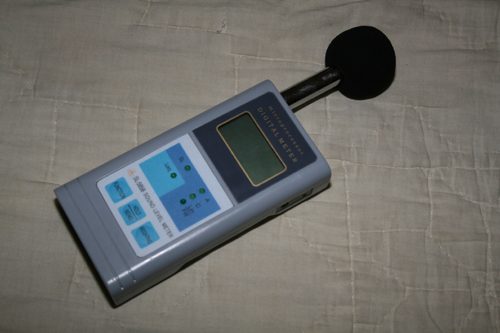

Sound Level Readings
SL-5858 Sound Level Meter
When this is being used, it is used in an as noiseless as possible room. A completly noiseless room is impossible to find so we go for as good as we can.
Measuring: A .40-125dB C. 40-125dB Line. 40-125dB
Filter
Detection characteristics: fast/slow
DC output: 10mv=1dB
Resolution:0.1dB
Accuracy: 1dB
